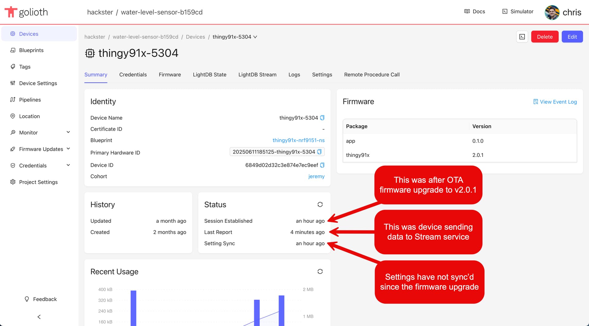

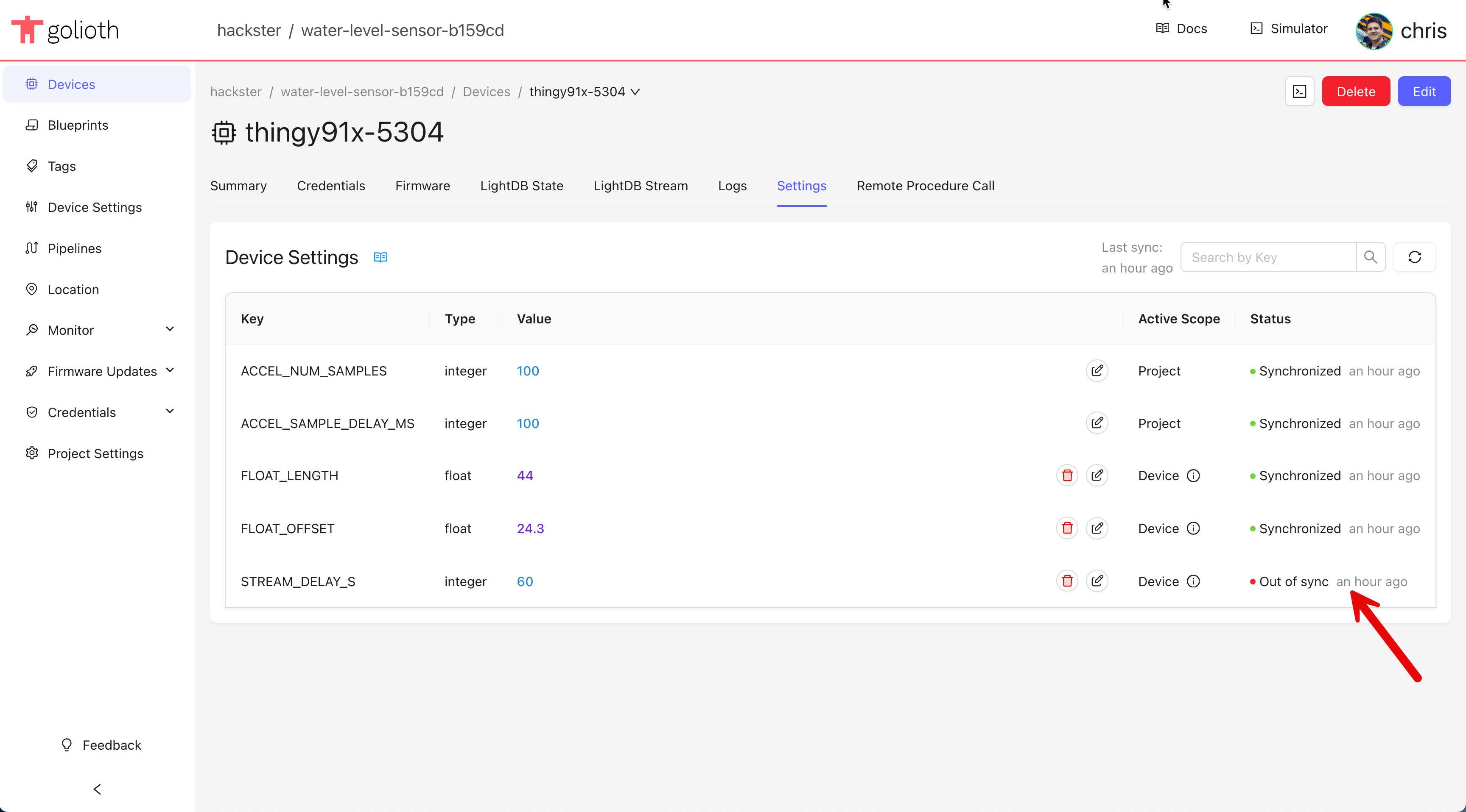

I’m seeing the same behavior (settings not updating) to what I originally posted after upgrading a second device now.
Here’s the sequence of events:

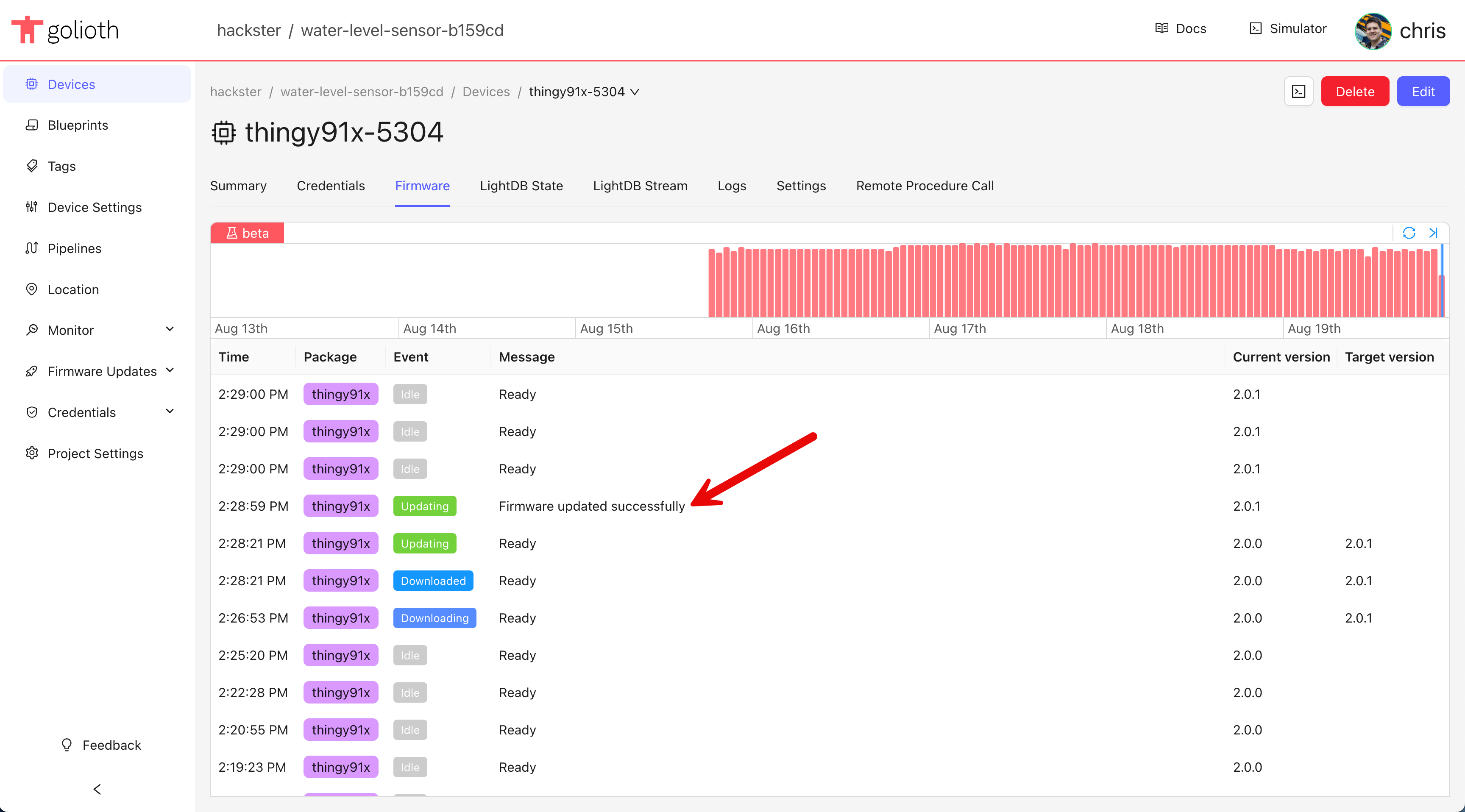

  1. Device was running v2.0.0 firmware
  2. I published a new v2.0.1 firmware and created a deployment in the cohort
  3. Device upgrades to v2.0.1 firmware successfully
  4. Device publishes new data to Stream service every 15 min
  5. Device settings still have not been synchronized since the OTA completed
Here’s the prj.conf from the v2.0.1 firmware.

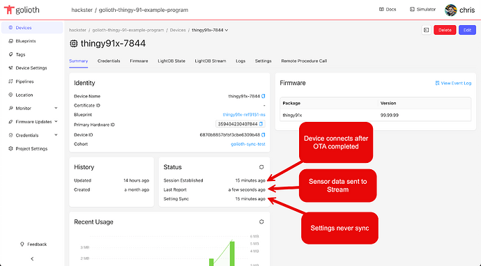

I was able to reproduce this behavior a couple different times on a modified version of the Thingy:91 Example repo where I removed the LightDB State & RPC functionality and changed the prj.conf for low power (here are the changes I made)
Here’s the specific behavior I’m seeing:
  1. After the device finishes an OTA update, settings are initially synchronized successfully with the device.
  2. The device transmits sensor data to LightDB Stream successfully on an interval defined by LOOP_DELAY_S (I was using 60s).
  3. If I change the LOOP_DELAY_S to something else (e.g. 65), the new setting is never synchronized and the console shows “Out of sync” indefinitely.
Here’s the exact sequence of steps I followed to reproduce this:
  1. I programmed the device via JTAG with the thingy91-golioth_v1.6.0_thingy91x_nrf9151_ns_full.hex pre-build release firmware.
  2. I created a sample project with the v1.6.0 firmware deployed in a cohort and added the device to the cohort.
  3. I built a new OTA firmware v99.99.99 from this modified branch of the Thingy:91 Example app: GitHub - cgnd/thingy91-golioth at cdwilson/golioth-sync-test (west build -p -b thingy91x/nrf9151/ns --sysbuild)
  4. I uploaded the zephyr.signed.bin as a new package v99.99.99 and created a new deployment in the cohort
  5. The device OTA upgraded successfully to v99.99.99 firmware and settings sync’d correctly

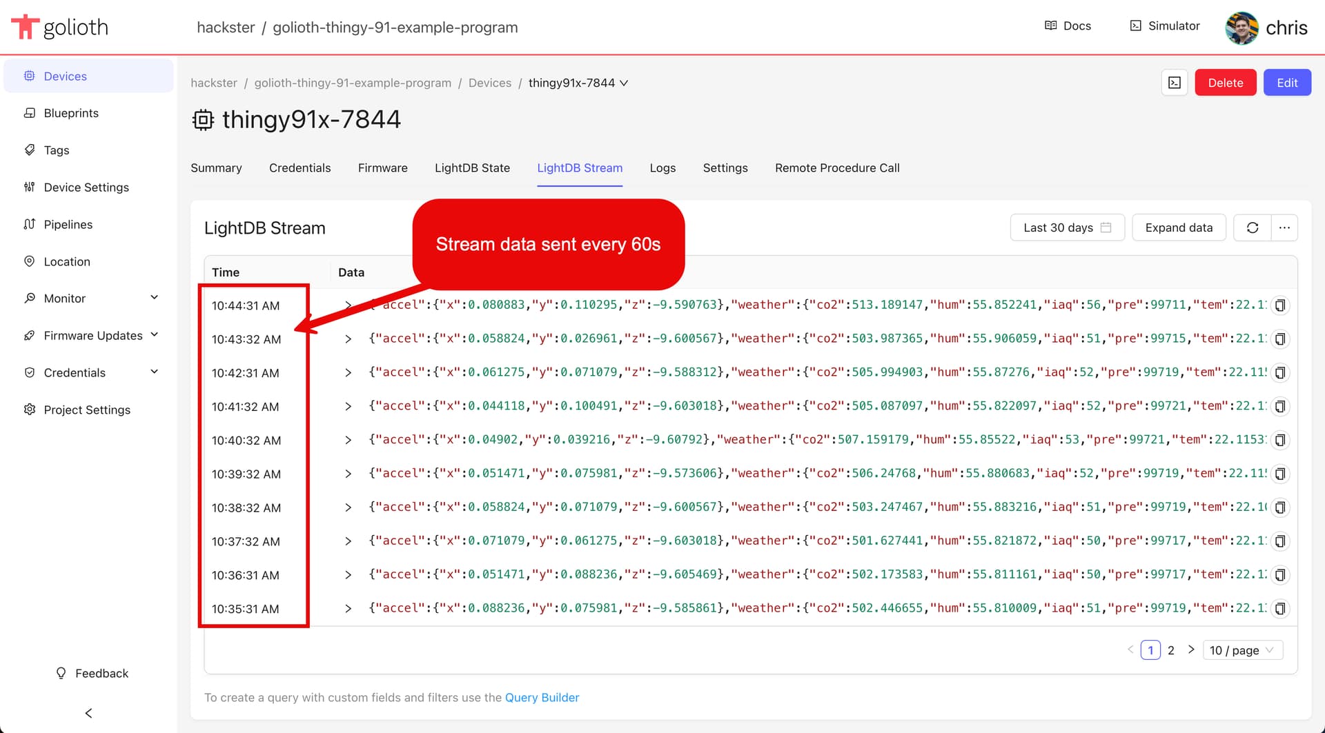

  6. I waited for a couple minutes to verify the device was sending Stream data correctly

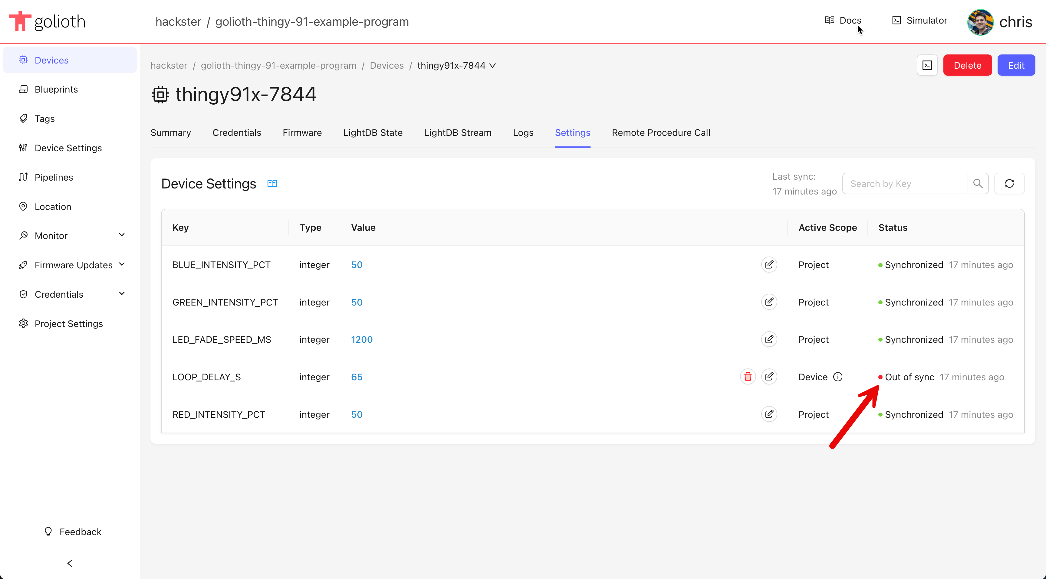

  7. I changed the LOOP_DELAY_S from 60 to 65
  8. The settings remain “Out of sync” indefinitely even though the device is sending Stream data every 60s.
It’s as if the Settings service gets “stuck” and the device can no longer receive new settings.
