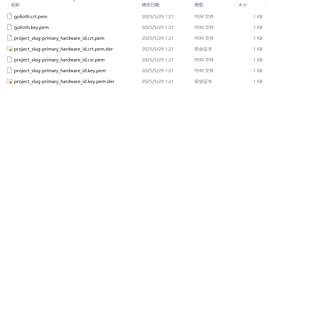

I used the certificate_provisioning project code and referred to the documentation, aiming to implement certificate-based authentication.
However, the device consistently fails to connect to the server. I have repeatedly reviewed my approach and haven’t found any omissions.

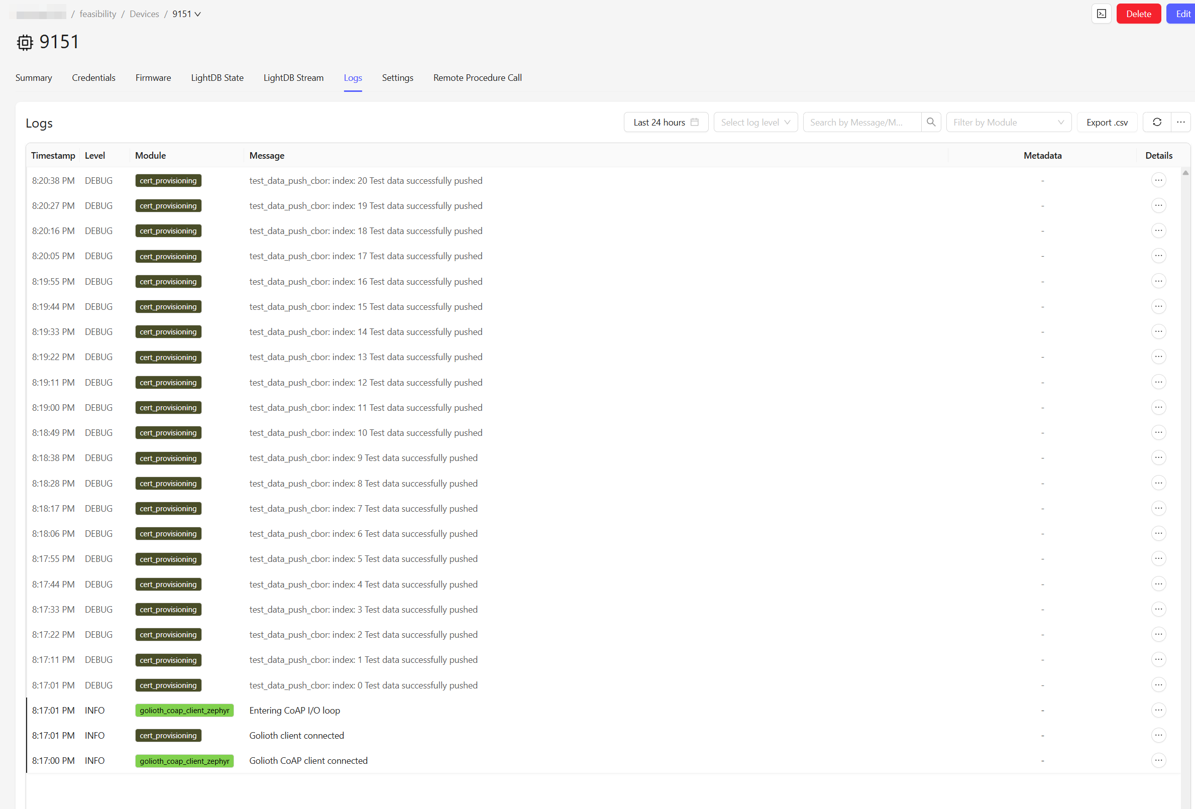

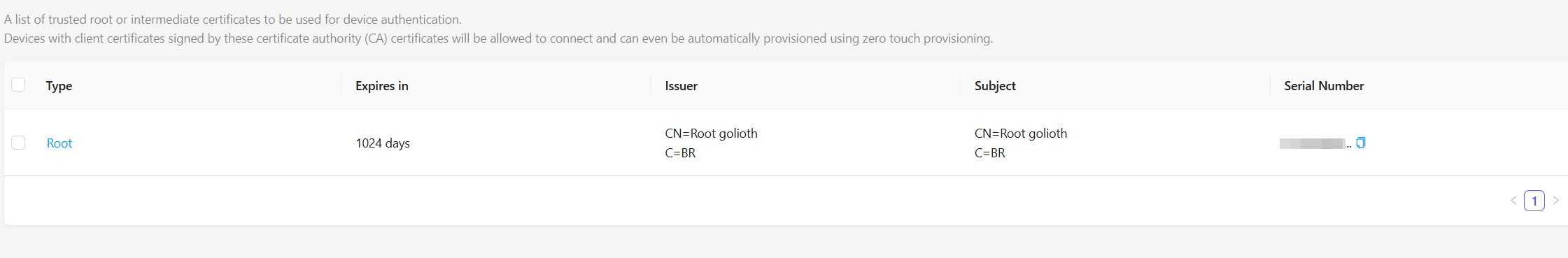

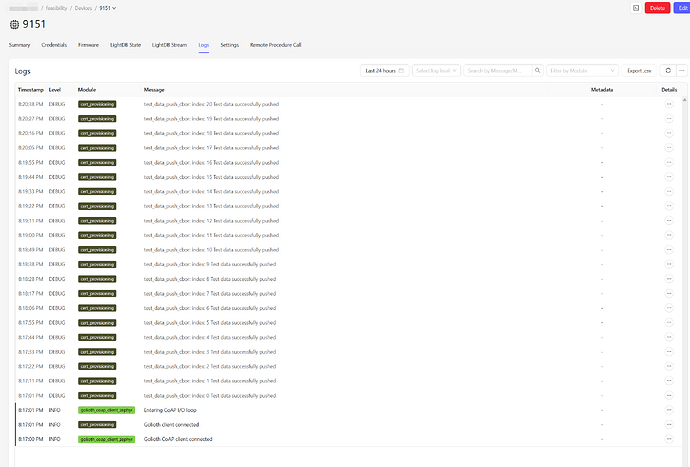

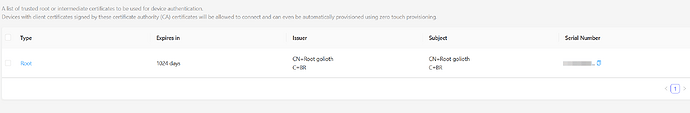

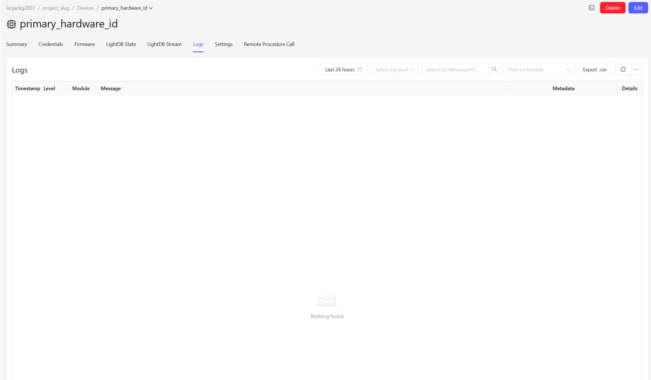

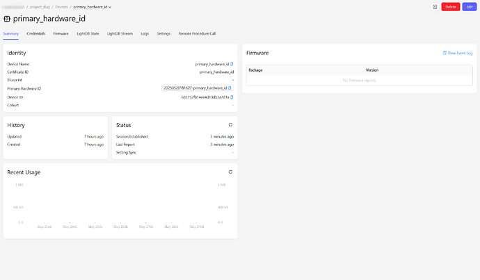

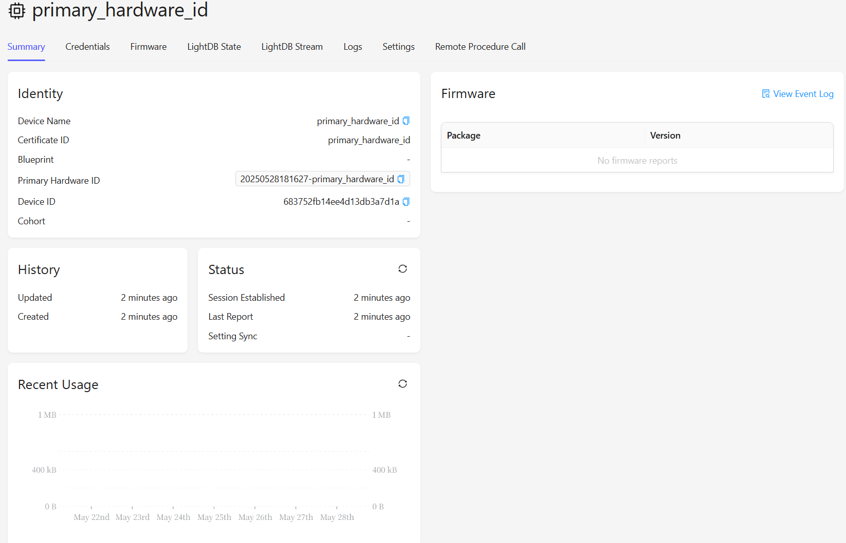

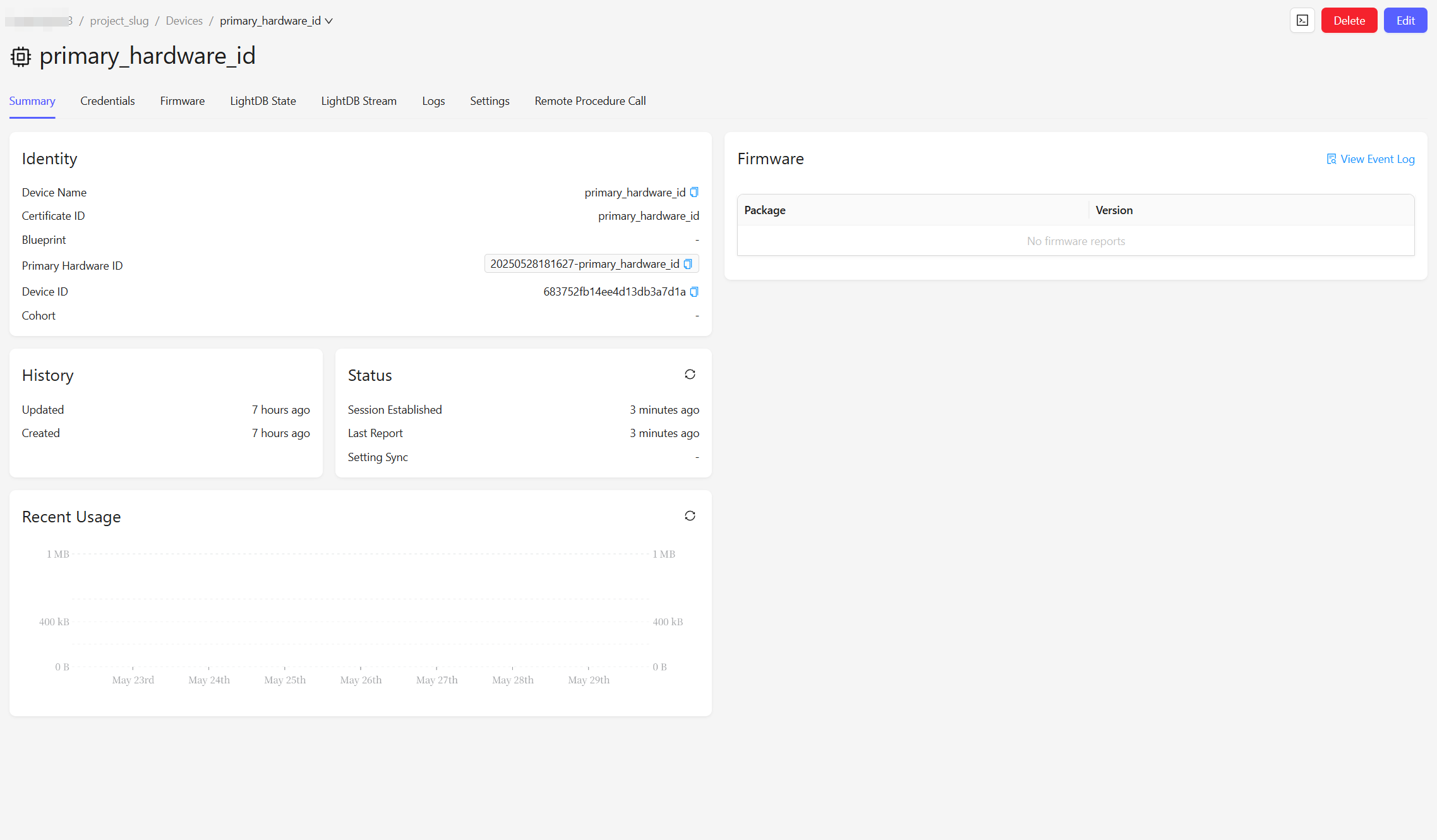

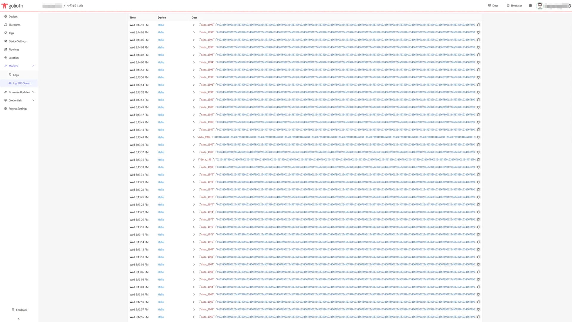

From the platform, it can be seen that the device has previously connected to the platform. However, it’s unclear why the device keeps reporting errors in the logs.
Like you said, it was able to authenticate and it shows in the status that is has connected. You’re still seeing logs on an on-going basis that show the -116 error?
From the server side, it appears that you were attempting to connect prior to this project being created but after the project was created were able to connect. If you can post updated logs, we’d be interested to know if this problem persists.
Yes, initially I configured the device first and powered it on before configuring the project on the server side. If the sequence of operations matters, I have already powered off the device and then powered it on again. However, the device log still shows the -116 error, which is quite strange.

Additionally, if needed, I can share the certificate I am currently using for testing with you. However, you’ll need to let me know how I should send it to you, as I haven’t found a way to upload attachments on the forum.
Hey @ChrisGammell, it’s very weird. After a period of -116 errors, the device successfully connected to the server.
The detailed logs are as follows:

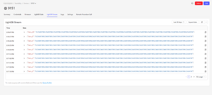

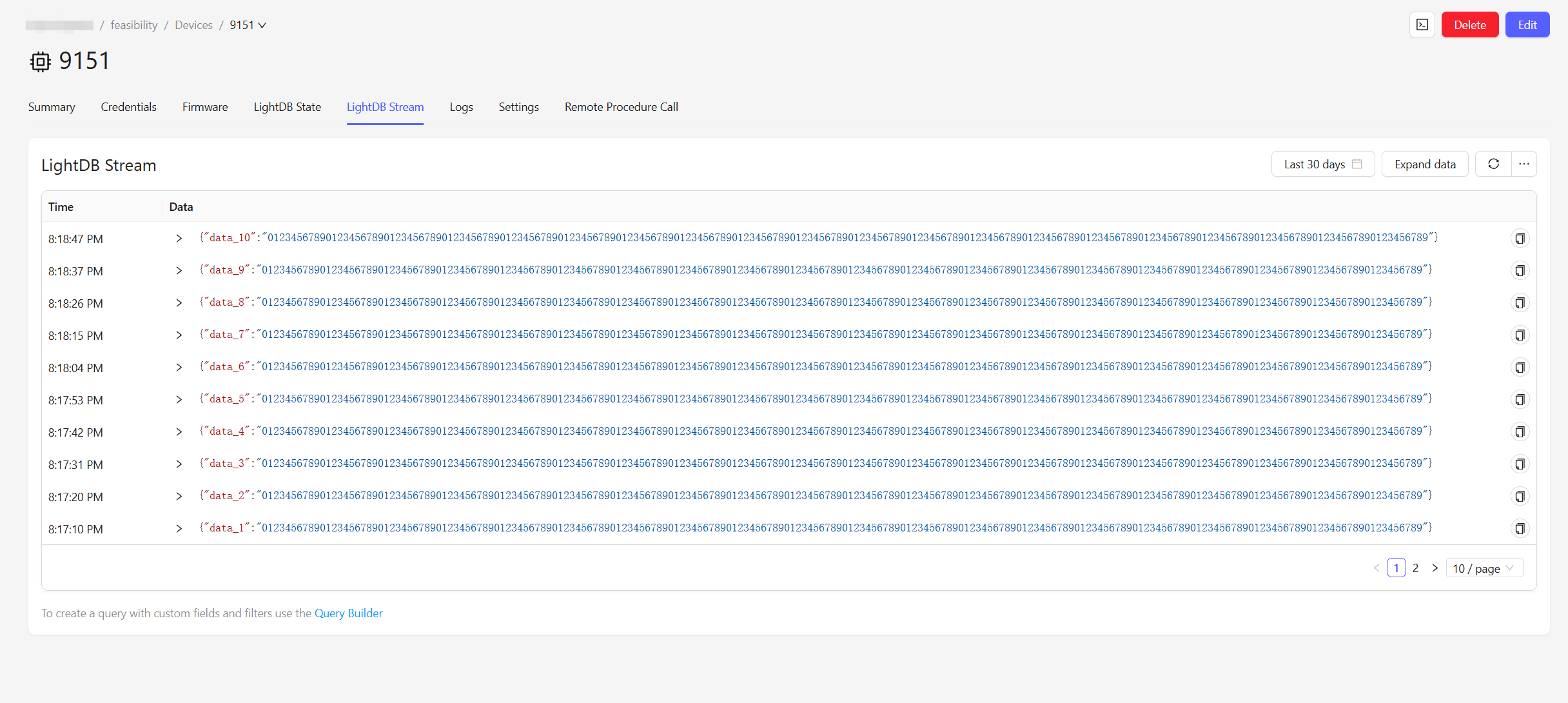

[00:21:16.939,300] <dbg> cert_provisioning: test_data_push_cbor: index: 60 Test data successfully pushed
[00:21:27.833,679] <dbg> cert_provisioning: test_data_push_cbor: index: 61 Test data successfully pushed
[00:21:39.351,104] <dbg> cert_provisioning: test_data_push_cbor: index: 62 Test data successfully pushed
[00:21:50.219,421] <dbg> cert_provisioning: test_data_push_cbor: index: 63 Test data successfully pushed
[00:22:01.099,761] <dbg> cert_provisioning: test_data_push_cbor: index: 64 Test data successfully pushed
[00:22:11.980,102] <dbg> cert_provisioning: test_data_push_cbor: index: 65 Test data successfully pushed
[00:22:22.859,436] <dbg> cert_provisioning: test_data_push_cbor: index: 66 Test data successfully pushed
[00:22:33.739,776] <dbg> cert_provisioning: test_data_push_cbor: index: 67 Test data successfully pushed
[00:22:44.635,131] <dbg> cert_provisioning: test_data_push_cbor: index: 68 Test data successfully pushed
[00:22:55.547,393] <dbg> cert_provisioning: test_data_push_cbor: index: 69 Test data successfully pushed
[00:23:06.380,828] <dbg> cert_provisioning: test_data_push_cbor: index: 70 Test data successfully pushed
[00:23:17.292,175] <dbg> cert_provisioning: test_data_push_cbor: index: 71 Test data successfully pushed
[00:23:28.173,522] <dbg> cert_provisioning: test_data_push_cbor: index: 72 Test data successfully pushed
[00:23:39.021,881] <dbg> cert_provisioning: test_data_push_cbor: index: 73 Test data successfully pushed
[00:23:49.902,221] <dbg> cert_provisioning: test_data_push_cbor: index: 74 Test data successfully pushed
[00:24:00.992,584] <dbg> cert_provisioning: test_data_push_cbor: index: 75 Test data successfully pushed
[00:24:11.678,924] <dbg> cert_provisioning: test_data_push_cbor: index: 76 Test data successfully pushed
[00:24:22.590,301] <dbg> cert_provisioning: test_data_push_cbor: index: 77 Test data successfully pushed
[00:24:33.456,665] <dbg> cert_provisioning: test_data_push_cbor: index: 78 Test data successfully pushed
[00:24:44.334,991] <dbg> cert_provisioning: test_data_push_cbor: index: 79 Test data successfully pushed
[00:24:55.176,330] <dbg> cert_provisioning: test_data_push_cbor: index: 80 Test data successfully pushed
Screenshot from the web page
What’s going on here? :thinking:
In addition, it’s not that every time the device is powered on again it can eventually connect to the server after a period of -116 errors. The success rate is very low.
