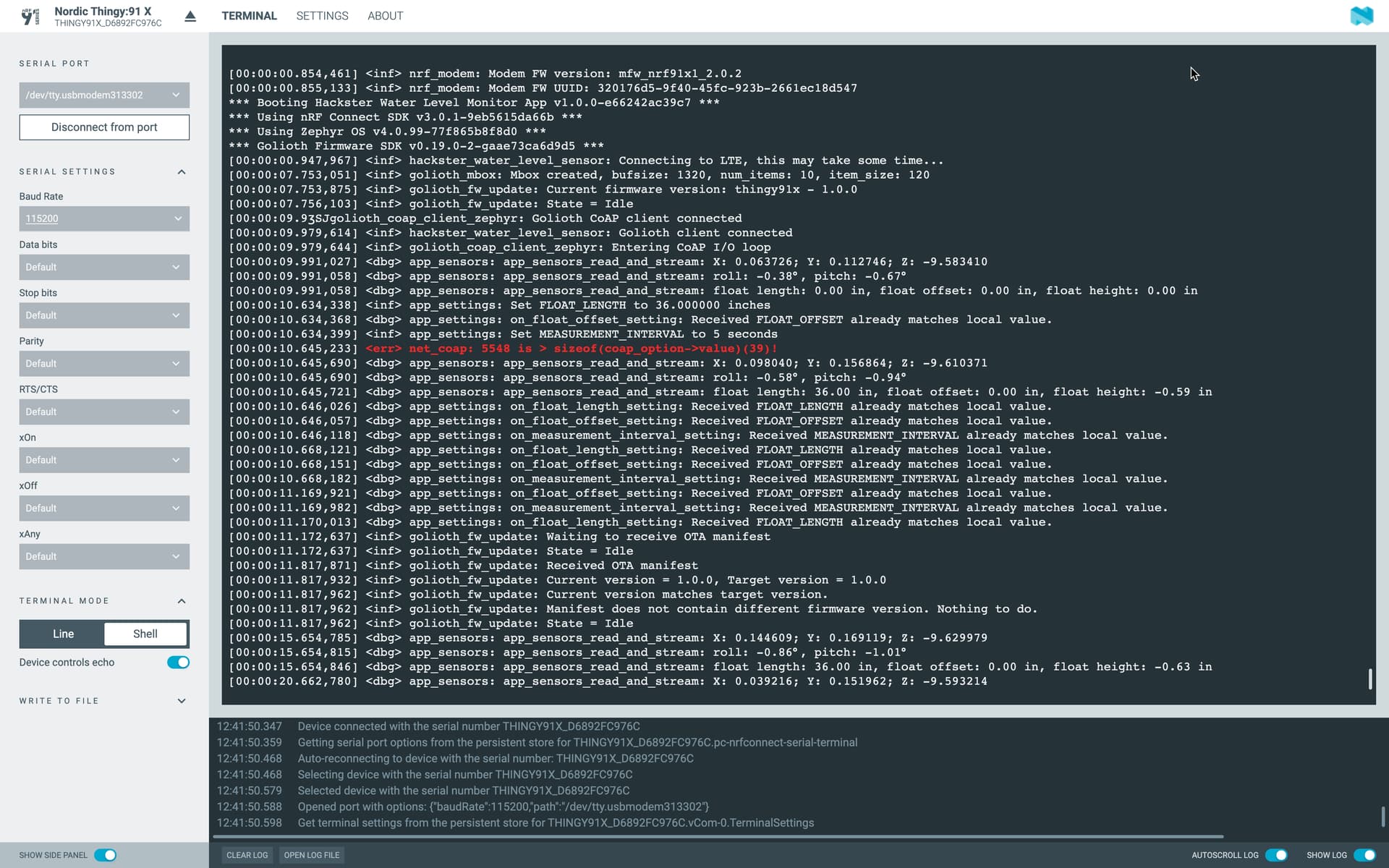

[00:00:07.728,027] <err> net_coap: 234 is > sizeof(coap_option->value)(39)!
[00:00:07.728,057] <inf> golioth_rpc: RPC observation established
[00:00:07.828,186] <inf> golioth_fw_update: Waiting to receive OTA manifest
[00:00:07.828,186] <inf> golioth_fw_update: State = Idle
[00:00:08.156,005] <inf> golioth_fw_update: Received OTA manifest
[00:00:08.156,066] <inf> golioth_fw_update: Current version = 1.0.0, Target version = 1.1.1
[00:00:08.468,231] <inf> golioth_fw_update: State = Downloading
[00:00:09.574,493] <err> net_coap: 813 is > sizeof(coap_option->value)(39)!
[00:00:09.574,615] <inf> golioth_fw_update: Received block 0/368

Will now move on to testing with NCS v3.0.1.
@hasheddan tested against NCS 3.0.1 and is getting the same behavior.
I am moving this issue to [email protected] so that I can send over the project files for your review.
Thanks
@rajeev sounds good, thanks for testing!
@rajeev I know you moved this to email, but if you figure out how to fix this, can you reply back to this thread? (I’m seeing the same error)
@cdwilson the net_coap length overflow issue is still pending (WIP) @hasheddan and team are working on that end to get it fixed. I think the Golioth SDK params, or probably the cloud side, needs to be fixed to overcome this length issue.
Thanks
Just adding here that we were able to work with @rajeev to determine that the firmware update issue was unrelated. This log message was added in the newly pinned Zephyr version in v0.19.0 of the Golioth Firmware SDK, so this is unlikely to be related to code changes in the SDK itself, but rather due to the Zephyr version bump. Nevertheless, we are working on tracking down the source of the issue and resolving it in a forthcoming release.
@rajeev @cdwilson providing an update here – @sam was able to track down the source of the issue and has implemented a fix (zephyr: coap: reset block context on first block2 response by sam-golioth · Pull Request #819 · golioth/golioth-firmware-sdk · GitHub). This will be included in an upcoming v0.19.1 release. Thanks again for the reports here!
@hasheddan thanks for getting the fix out. Will continue testing and report if any other bugs might appear.
We just released v0.19.1 of the Golioth Firmware SDK, which includes this fix. I’ll close out this topic as resolved, but please let us know if you experience any further issues. Thanks!
