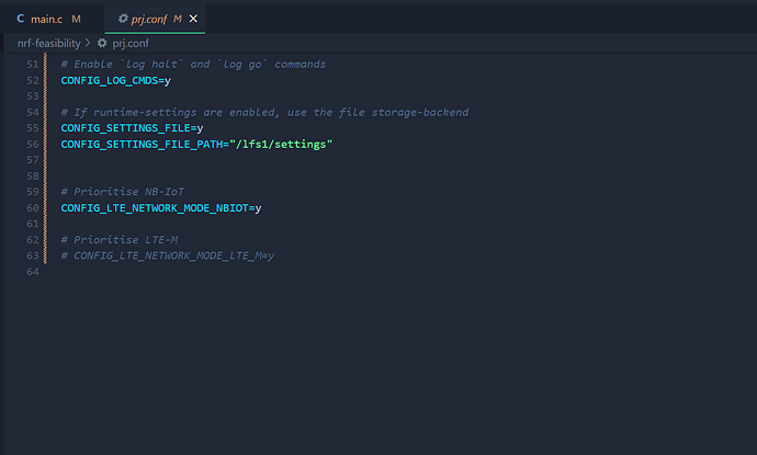

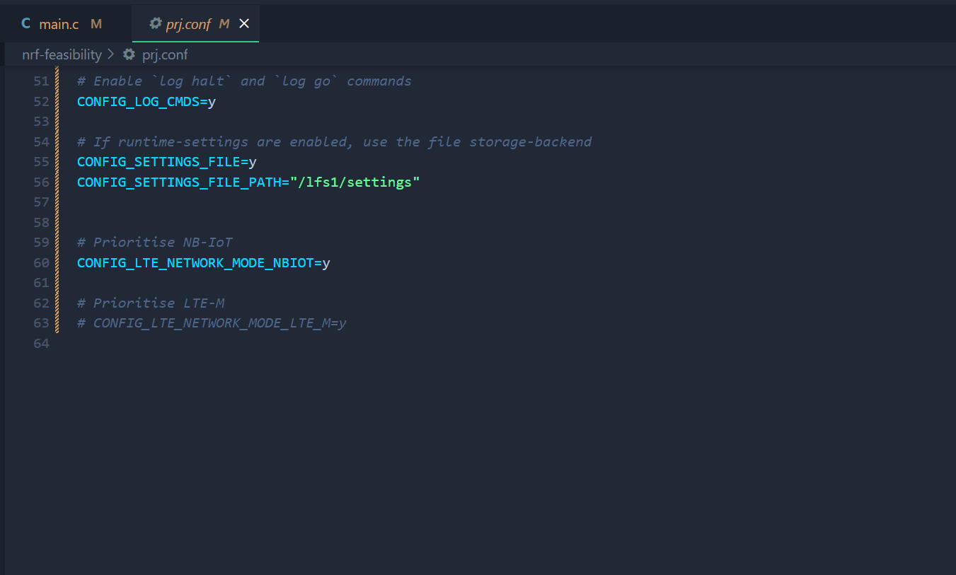

Previously, I had already used the at_client firmware and successfully configured the device to NB-IoT mode using AT commands.
However, in the Zephyr project, adding CONFIG_LTE_NETWORK_MODE_NBIOT=y to prj.conf still had no effect.
Referring to the following method, it still takes a very long time to connect to the network. :rofl:
switch-between-cellular-standard-in-zephyr
[00:00:00.535,919] <inf> golioth_samples: Bringing up network interface
[00:00:00.535,919] <inf> golioth_samples: Waiting to obtain IP address
[00:01:11.900,756] <inf> lte_monitor: Network: Searching
[00:01:14.754,272] <inf> lte_monitor: Network: Registered (roaming)
