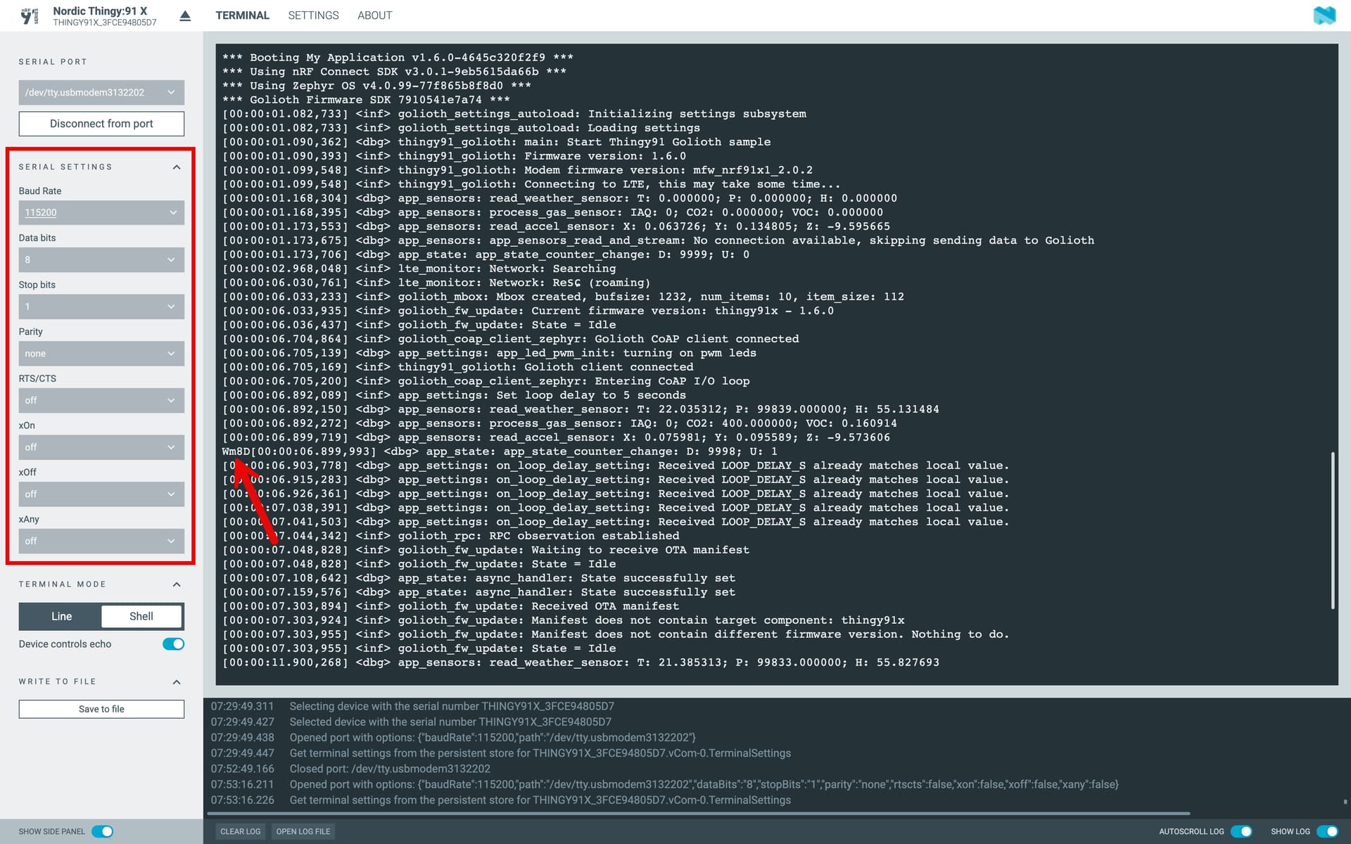

Tested it just now with both Minicom and the nRF Terminal, and I wasn’t able to reproduce the issue. Can you check if the malformed characters always show up in the same position? Also, can you confirm that the UART baud rate set in the application matches the one configured in the terminal?

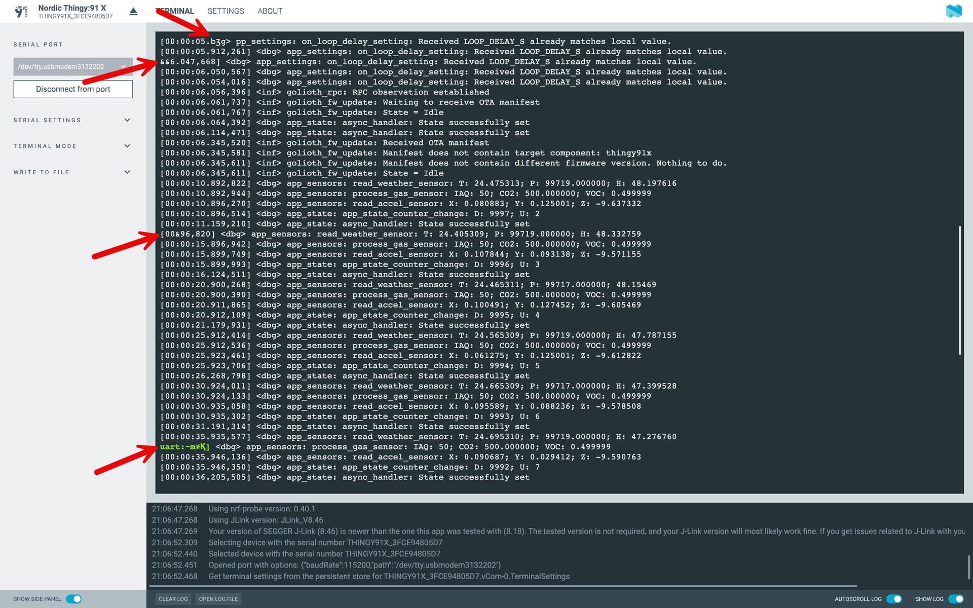

What was the LOOP_DELAY_S you used? Can you try setting it to something low like 1-5 seconds and see if you notice any malformed characters? I’m still seeing the issue with the default delay of 60s, but I see it more frequently when the delay is low (like 5s).

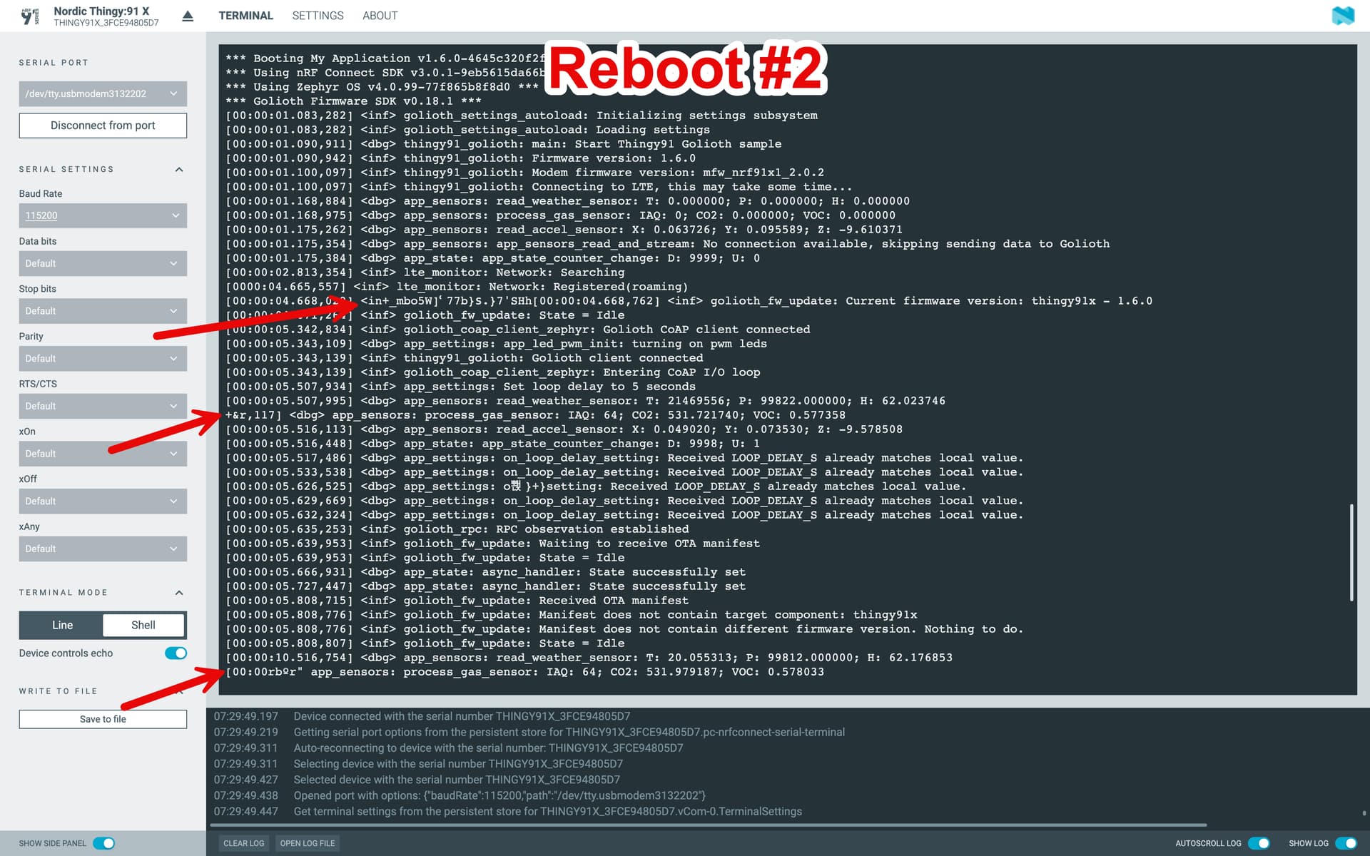

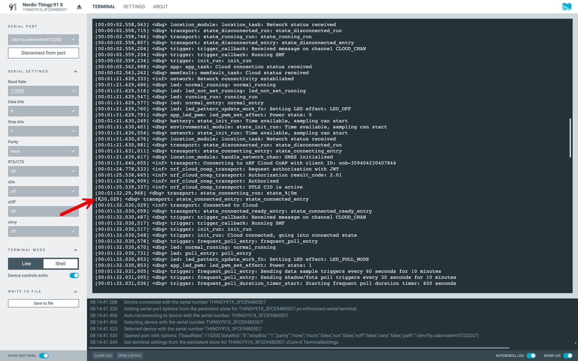

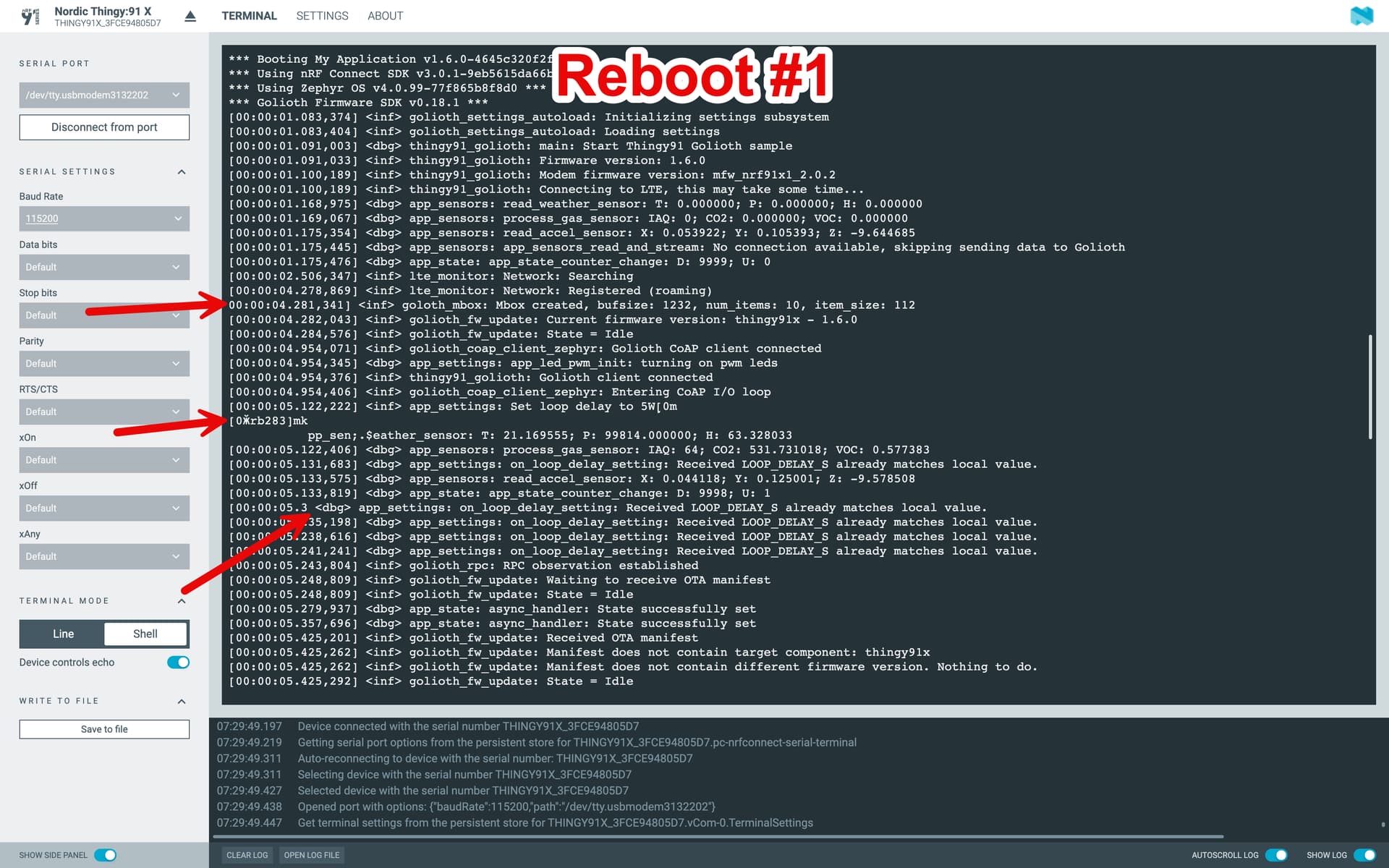

They don’t show up in exactly the same position each time…it seems a bit random. Here’s a couple screenshots right after a kernel reboot cold on the same device.
Devicetree for both the nRF5340 and the nRF9151 show the following speed (and I’m not changing it in any overlay in my app):
current-speed = <115200>;

In that first image, you have what looks like a shell output prompt (uart:~)
Have you tried turning off the shell to the UART and see if that still happens? Might be some kind of interaction/overwrite that’s happening? Any chance a keypress is happening when the garbled output occurs.
