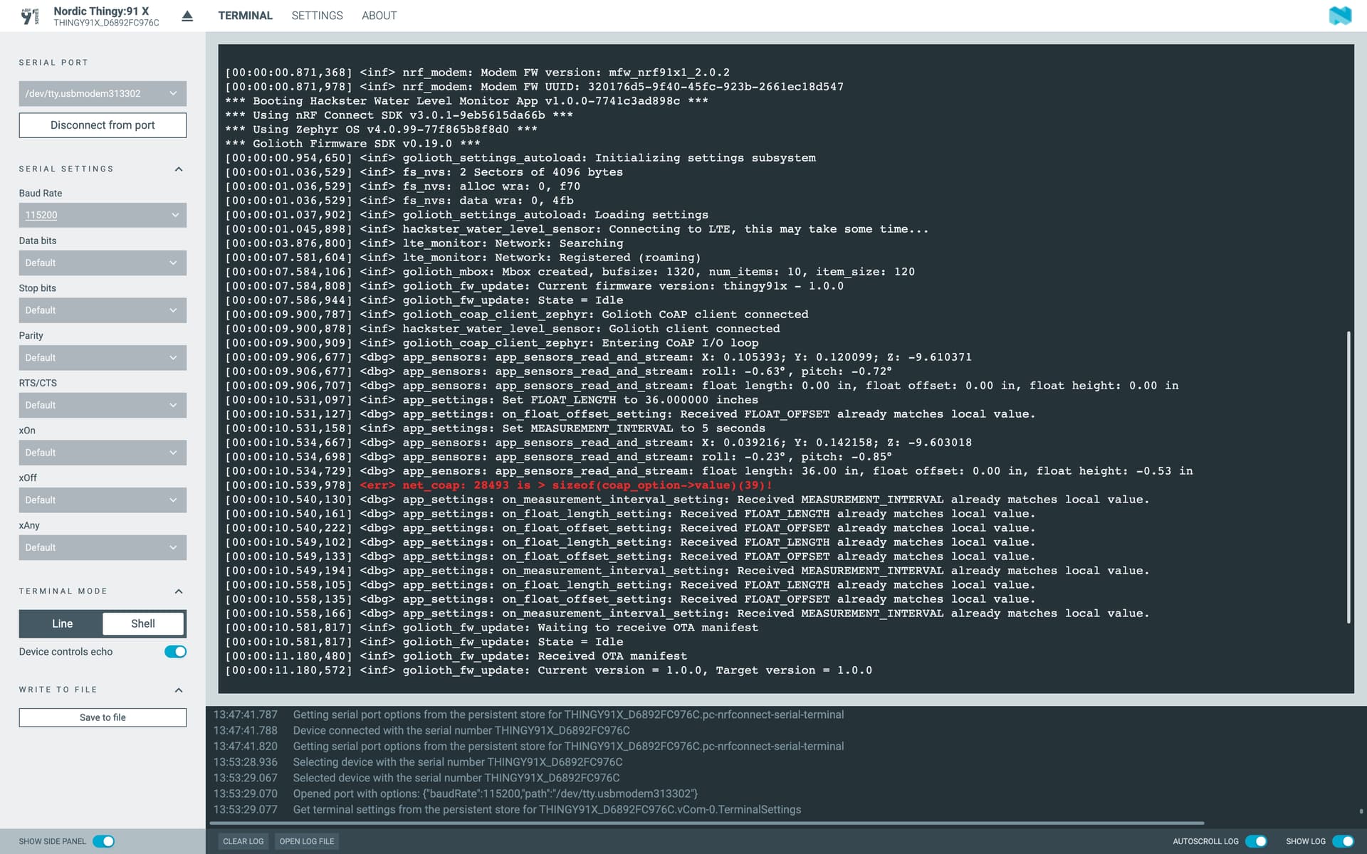

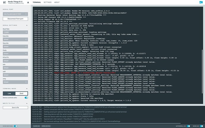

  2. I’m seeing errors in the serial console like the following on boot now:
[00:00:10.895,874] <err> net_coap: 166 is > sizeof(coap_option->value)(39)!
Here’s a screenshot showing it in the boot-up sequence:
I haven’t had time to look into this one, but I’m hoping you might know what is causing this.
My current config is just copied from the Thingy:91 Example App (TBH, I’m not really sure what these do):
CONFIG_COAP_EXTENDED_OPTIONS_LEN=y
CONFIG_COAP_EXTENDED_OPTIONS_LEN_VALUE=39
EDIT: ignore original comment below, this is actually happening randomly whether or not CONFIG_LOG_BACKEND_GOLIOTH is y or n. After rebooting a bunch of times, it shows up randomly (but not always) with either setting.
I forgot to mention that I’m only seeing these errors when the golioth logging backend is disabled in prj.conf:
CONFIG_LOG_BACKEND_GOLIOTH=n
When I enable this config, I don’t see these errors.
